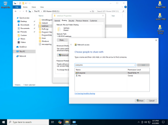

Create a shared folder on each computer.
You can name the folder anything you want, but in the illustration below I named the folder "netshare". Then right-click the folder and select "Properties" -> [Sharing] tab -> and click the [Share...] button.
This may be optional for you, but I'm sharing folders with the family so rather than choosing names I just add "Everyone" to the list and set the permission level to "Read/Write".
Finish by clicking the [Share] button.
Warning: Do not try to share the root directory of a drive! It can be done, but it's difficult and you'll just make more headaches for yourself.
Warning: You can share a folder or a subfolder, but try to avoid sharing any folders in the "C:\Users\{name}" folder because different Windows versions impose extra restrictions on that directory tree. Sometimes it works, sometimes it doesn't.

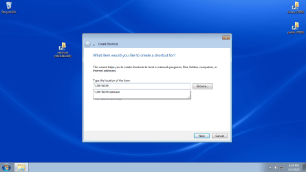

Create a shortcut on each computer to the shared folder on the other.
Right-click on your desktop and select "New/Shortcut". Starting with two backslashes, type the name of the network share on the other computer. Note you can use either the machine name or the IP address.
Now you should be able to double-click the shortcut and see the contents of the shared folder on the other computer.

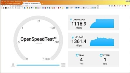

As a postscript to this thread, I just happened to listen to a recent episode of Steve Gibson's "Security Now" podcast. It has a brief segment mentioning how to test your LAN speed.
The podcast is here. Skip to about the 1:34:20 time mark for the start of the short, 3-minute segment.
I tested it on my LAN. It's pretty slick. You start by downloading a portable "server" app from the OpenSpeedTest website. Launch the portable app and get its server going on one machine, then on your other machine open any web browser and go to the server's IP address, which will be something like "192.168.0.2:3000".
It looks and operates similar to familiar internet speed tests from Ookla or your ISP, but it works from machine to machine on the same LAN to test your LAN speed instead of your internet speed.
