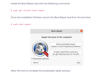

Boot-Repair - Community Help Wiki (ubuntu.com)
does say it can remove grub and restore mbr to windows
Boot-Repair also has advanced options to back up table partitions, back up bootsectors, create a Boot-Info (to get help by email or forum), or change the default repair parameters: configure GRUB, add kernel options (acpi=off ...), purge GRUB, change the default OS, restore a Windows-compatible MBR, repair a broken filesystem, specify the disk where GRUB should be installed, etc.

That worked real well....
Cant upload pics here but here are the total fails both programs are that people say fixes all grub issues
and running apt-get failed to get the needed files, they dont exist at zerobounce.net...
Shared album - Scott Downey - Google Photos
