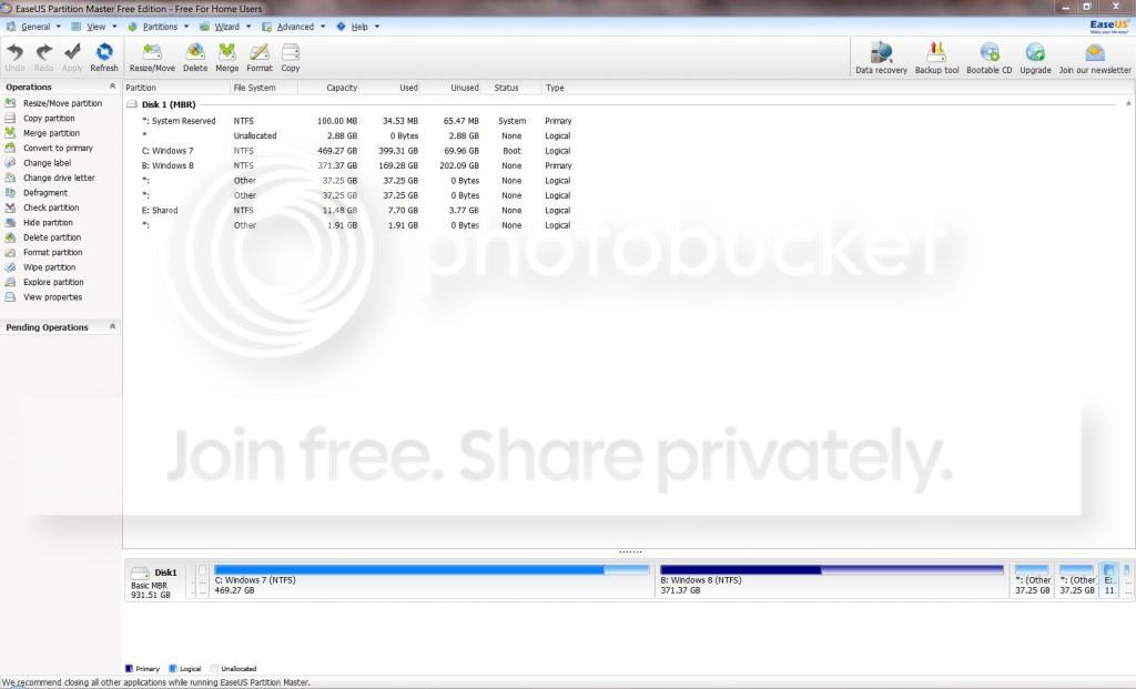

Thanks guys, I have to say what I am going to write is odd.
Linux Mint via the USB stick this morning started having problems in mounting the partitions, so I though, 'well, let's restart it, it's a live USB stick anyway'; I failed to press on time the F key to select where to make the system start from, and grub appeared as nothing had happened. Writing now from Windows 7, in fact.
Windows 7 is still as logical partition, and it works. I remember it was like that, I changed it as primary I don't remember why, and then 2 days ago all the mess happened.
Here the screenshot of easeUS Partition Master:

System Reserved is still Primary and booting the OS(s) as signified by the System flag on it. So you should be good to go to do the Upgrade of Win7 to 8.1 if you really wanna give up Win7 for that. Only the System boot partition must be Primary in order to boot all OS's.
System Reserved should also be Partition Marked Active so I would do that next.
If the Upgrade overrides GRUB then I would add the Linux back using Barman's method in Dual boot Ubuntu-Win7. Read over the tutorial also for Dual Boot - Windows 7 and Linux - Windows 7 Forums

Okay, so does this mean that only the first voice should be Primary? Not W8?
Another vaguely related question: there are those unallocated 2.88Gb that I suspect are making mess in Linux, as Gparted doesn't recognise the disk because of overlapping partitions.
Looking better at here I saw that sda5 (windows 7) and sda3 (f W95 Ext'd (LBA) ??) are overlapping.
can that sda3 be the unallocated 2.88Gb? I'd say no, as they are unallocated and if they were allocated to W7 they wouldn't be unallocated in the first place...
Why Linux shows 9 partitions while Windows just 7?
