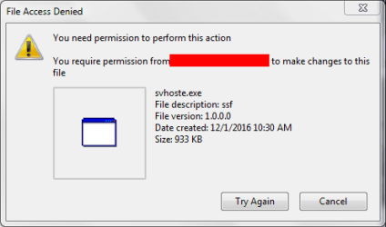

the file "C:\ProgramData\Client\Svhoste.exe" is definitely a malicious file, as it keeps taking over and erasing the data of other exe files while i am using them, leaving an empty .exe file behind. When i try to remove, replace, or rename the hollow exe file it tells me its in use by another program. Process explorer shows that svhoste.exe is using the file. when i try to kill the process it immediately opens an infinite number of svhoste processes. Both ASC 10 pro and mbam pro do not detect it and when i try to remove it manually, it says:
attachment.php
I require my permission to make changes. I can't seem to change anything about it even if i run programs as admin. What should I do? i have a feeling that it is only a matter of time before it messes with something vital to the computer.

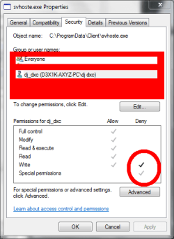

attachment.php
Note: denial overrides allowance
