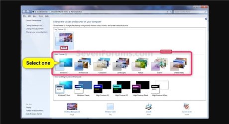

Hello mate, :-)
It sounds like you changed your theme to a High Contrast theme.
If so, you can change your theme back to the default Windows 7 theme using the method in the tutorial below.
Theme - Change or Save
Hi, brink, i could delete the theme in MY theme.
But what i want is , just restore the defaults to all the themes
i could not locate easily , as the selected letters are in dark blue and the letters are in yellow colour.
please give the exact item no in the tutorial to proceed.

Basically to use Option 2 in the tutorial at the link below to select the Windows 7 theme under Aero Themes.

You don't need to be in the "Windows and Color and Appearance" window.
Instead, select one of the "Aero Themes" in the screenshot behind it above the high contrast themes like below. Windows 7 is the default, but you can use any one of the Aero Themes.
