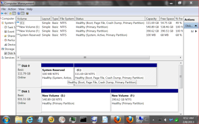

I think a picture of Disk Management would be helpful.
