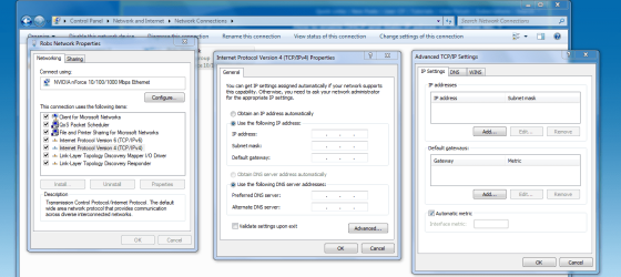

Have you attempted this using the Advanced TCP/IP settings window? You can configure it to work with more than one provider and I think the routing can be changed by configuring the IP, subnet mask and default gateways.
