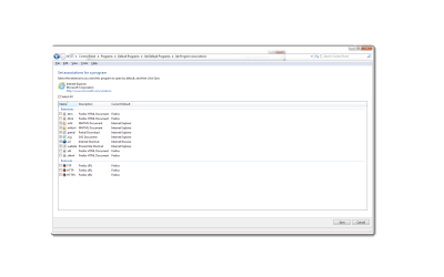

Yes I have, that's my problem. Firefox is not a choice as a default program (see attached screenshot). I browse to Program Files\firefox.exe and click open but it doesn't populate as a program to 'open with'.

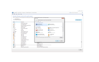

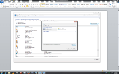

Click on the arrow to the far right of "Other Programs" to see if it may expand open to see any available programs to hopefully be able to select Firefox.
Yes I already had did that and it wasn't there and I'm unsuccessful putting it in there when I browse to firefox.exe.
