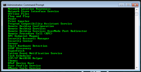

The service is running as per "net start":
attachment.php

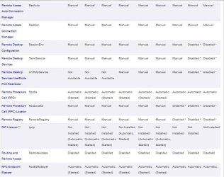

I did not go through your external links to check if they mention whether or not you have the Services set properly for both machines.
I surmise you have double checked the reasons in this Alert box.
The suggested settings from Black Viper:
