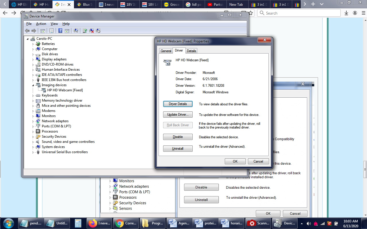

i did,
it says:
HP Webcam [Fixed]
what is "Fixed"?

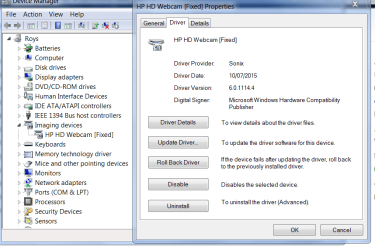

hi
if that driver is sonix, try version 6 0 1114 4 dated july 2015.
thats the latest on my hp eb8470p.

hi

i did it :(
any idea of what the "fixed" means in the device manager list?
HP Webcam [Fixed]

Hi
just the way HP want to describe it !!!
so what driver is installed - i know mines been updated as Roll back is available.
have you got any other non-working drivers??
as a last resort can you run the tool from here, ignore the title it provides a great deal of info

hi
thats the base MS generic driver!!!
hit the update driver option, it should give you the same as mine
if not update again but select browse my computer then use the let me pick option
UNTICK show compatible hardware
scroll to sonix >>then in right hand box select hpcam fixed
then check which driver has been installed if its snic lower than 1114 update normally again
