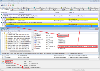

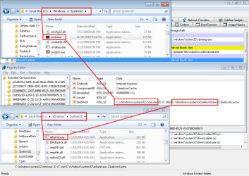

Let's start with what I see for a "good" entry shown in Autoruns and the registry:
The important part of the first screenshot shown below is at the very the bottom - the path to winmail.exe. That is the exe that the registry says should be on the hard drive. Since Autoruns found that exe, it showed the line in Autoruns as okay.
For whatever reason, Autoruns thinks that there should be a program named start; but when Autoruns cannot find start on the hard drive, it marks that row in yellow and declares File not found.
C:\Windows\system32\cmd.exe and C:\Windows\system32\ie4uinit.exe are clearly present on the hard drive.

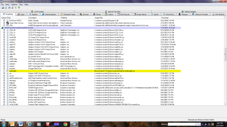

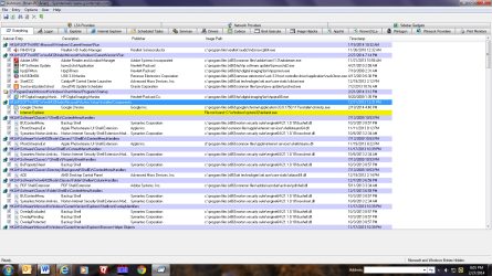

Screenshot of ie error and Antilog32 error in Autoruns
This is the ie4uinit.exe error in Autoruns. I also have an Antilog32 error further down in autoruns.
I hope I did this right and THANKS for the HELP!!!

Screenshot requested.
Here is the screenshot of ie4uinit.exe issue. But I do have another Autoruns issue with Antilog32 shown below.
Thank you SO MUCH for any HELP!!!

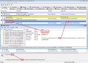

Callender was find enough to discuss this thread via PM with me. We discovered that we are seeing different things from autoruns because we have different versions installed. The tool has changed the way that it parses this info:
[COLOR=Red]C:\Windows\system32\cmd.exe /D /C start C:\Windows\system32\ie4uinit.exe -ClearIconCache[/COLOR]
Autoruns v11.34 parsed that string and went hunting for the non-existant file named "start". As post #4 shows, autoruns v11.34 can use a hard link for C:\Windows\system32\ie4uinit.exe and show that things are okay because it found the actual file in the WinSxS folder.
Autoruns v11.70 parsed that string, went hunting for ie4uinit.exe but failed to resolve the hard link.

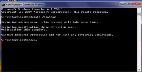

Screenshot you wanted and runscanner.log file
I thought this REALLY could help! Look at all of the missing files at end of log!
View attachment runscanner.log

Thanks for running the SFC scan. The results show ie4uinit.exe to be alive and well :-)
Doh! I now see that Callender was passing along some info about how other tools don't always find files that are hard links. I'm not sure that Callender was asking for the results of the scan. I'll let Callender help you with those results.
