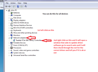

Have you tried Device Manager and clicked on all the devices and checked the drivers for all? See pic
