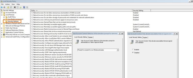

Hi hackerman1,
What if the issue is a change in your PC's config, not Emisofts'? Check secpol.msc User account control settings, especially two in the screen prints I took below. The pics show the defaults for Windows 7.
I'll have a bit of a think and see what else sprigs to mind, will let you know if I come up with something.
PS: I know you said you haven't changed anything; but please check anyway; besides you may be able to massage your settings here to make it work (balance that with security of course :) ).

hi !
thanks for the tip about secpol.msc.
but i can´t check that now.
yesterday i decided that i had wasted too much time on this.
so i uninstalled a2, then i tried to start a2.exe from another folder in which i have another a2-installation for WS-2008,
that a2start.exe had normal rights BEFORE i uninstalled a2 from W7.
but AFTER the uninstall it got changed to "Run as admin" !
so i then reinstalled a2 to another folder with another name, as i suspected i would get the same problem again otherwise.
now everything is normal again with a2, no UAC-prompts anymore.
the a2start.exe in the WS-2008 installation is still marked as "Run as admin"...
i´ve checked secpol.msc:
"Behavior of the elevation prompt for administrators in Admin approval mode"
is set to: "Prompt for consent on secure desktop"
"Behavior of the elevation prompt for standard users" is set to:
"Prompt for credentials on secure desktop"

RE: Secpol
hi!
Note the difference in your "Behavior of the elevation prompt for administrators in Admin approval mode"
I'm pretty certain that the default should be "Prompt for consent for non-windows binaries"
I didn't mention previously but "Behavior of the elevation prompt for standard users" should be "prompt for credentials".
Perhaps WindowsStar or another reader can verify theirs?
