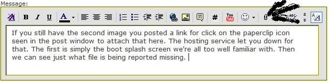

If you still have the second image you posted a link for click on the paperclip icon seen in the post window to attach that here. The hosting service let you down for that. The first is simply the boot splash screen we're all too well familiar with. Then we can see just what file is being reported missing.
