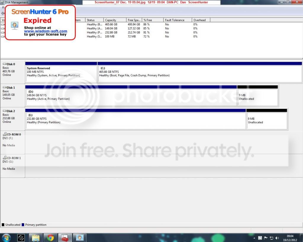

You should access bios on power up to see if the drive in question is shown
If it is not there then your machine is not recognising it and windows will not see it
If it is there then please post a shot of your disk management window
Start>type diskmgmt.msc>enter

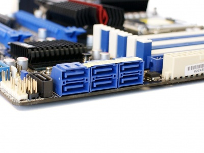

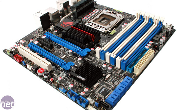

Is it connected to the single black SATA port on the motherboard, or in the blue group of six? If it is the black one either check the bios and make sure the JMicron controller is enabled, or connect it to a spare port on the blue ones.

I'm going to do a print screen and then check the BIOS.

stormy13 - Its connect to the group of 6 Blue SATA ports (Bottom right, under the iROG Chip)

I think you've spoke to soon.
I have just visited the BIOS and it shows it in there. I then came to the desktop and went to 'My Computer' and it wasn't showing the drive.
I've inserted the Asus Rampage M/b CDROM to see if there is a SATA driver I should install and I put it into the new CD drive and it didn't play it automatically like it should. It doesn't even show in 'My Computer' :cry:

Check disk management again see if its still showing
Do you have two optical drives?
Intermitent behaviour like this is normally caused by a bad connection or a faulty drive, i would unplug both ends of sata cable and reconnect, do the drive drawer still open and shut when device is not listed?

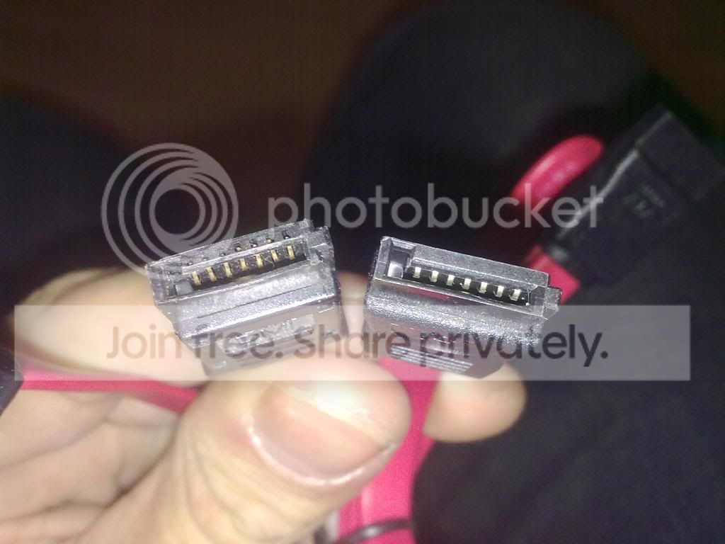

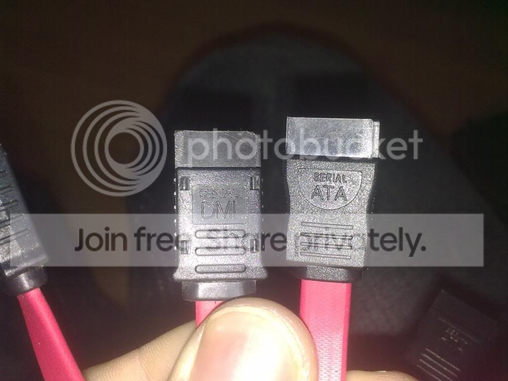

Thanks to all those that have helped by none of you were correct :P
After finding out that it showed in the Bios and sometimes in My Computer, I started to wonder if there was a loose cable/ dust in the system.
I took my computer apart and there wasn't much dust (cleaned out every other month). I progressed to find the 'Sata' cable. I took it out (expecting a broken wire or something) and I was surprised to see that I installed a DMI cable instead (Desktop Management Interface).
Its clear that some information was getting transferred between the hardware and PC but not all of it. I now have bought a REAL SATA cable and works a treat now.
The DMI cable on the left. At a glance it looks exactly the same as a Sata cable
The DMI cable is on the left. You can see that the pin structure is completely different from the SATA cable. Although there is the same amount of pins, I will assume that they weren't quite the right size to carry the information on the spacing was slightly different to the SATA one.
Lesson to be learnt.. Carefully check your cables if installing new hardware.
