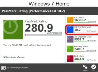

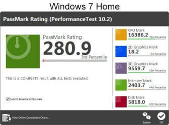

I ran Passmark Performance Test v10 on my current GB 970A system running W7 and compared that with a GB AM4, both with NVidea cards.
There wasn't a whole lot of actual difference in speed. The score was better with most, but not all the categories.
Considering the number of Processors that are running, in W10 which is at least 3x more than W7, I can see why there wasn't a big difference.
The svchost.exe count in W10 had to be over 50 compared to around 15 or so in W7.

I have no idea why the overall score on your W7 setup was so low. Also, why is the Disc score lower on the W10 machine? I've never used a 'Home' version with any of their O'S's, but I find it hard to believe the overly bloated W10 would score faster overall.
Frankly, I have reservations about their testing software.

Looks like there is problem with the graphics
