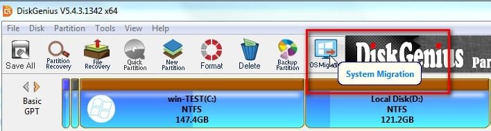

why didnt you just migrate the os from the hd to the ssd?
ssd manufacturers often have tools you can d/l to do it. The samsung one is apparently good. Or other free programs such as diskgenius have os migration feature.
