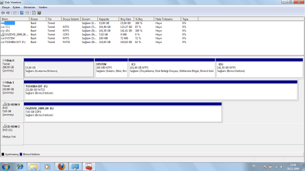

Post a Disk Management screenshot.

here is the disc management sc. i noticed that the first partition is the recovery one, where is the mbr then? anyways, i am wondering, in my previous experience, how could i manage to erase the sata drivers and ended up the installer not finding any harddisk to install on. i mean, i used the very same cd and successfully installed win7 on a newly formatted partition. you guys have any explanation for that?

The MBR is in the System partition 100mb, which also makes the same Repair tools located on Installer/Repair disk avaiable at F8 during bootup.
I like your plan to boot from Win7 DVD and wipe the entire HD then let Win7 decide on 100mb. But iseeuu gives a way to avoid it above if you choose.
If you are worried about the SATA drivers needing to be available for the installer in the future, just back them up. It is rare for the Win7 installer not to have them already.
As far as the first partition goes, I cannot translate it from screenie, but it is surely a recov partition. Your best move would be to recover that valuable real estate by deleting from the DVD tools during install, and then later create a system image of your finished installation stored externally.
If you can make Recovery disks from that recov partition, I would as might want to restore to factory condition to sell the computer and migrate your 64 bit Upgrade elsewhere. In rare circumstances, makers can also require factory restore to service hardware warranty; you can ask them.
