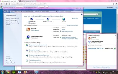

I have tried everything. Just everything. What am I doing wrong!?
Yesterday I got a laptop from a friend that isn't that handy with computers. The first thing i did was to buy a windows 7 ultimate 32bit copy for her, formated and replaced her vista. Its a pretty old laptop (Zepto A15 with 2gb memory, 2 gHz intel pentium) so I expected some problem. Among others to find right drivers for the Nvidia 9600M GT card. But now im completly stuck.
The attached picture explains my problem pretty well. This i have already tried:
1. Reinstalled the network devices (both ethernet and wireless). This is pretty strange I think though. The etheret device is named Realtek RTL8168C(P)/8111C(P) Family PCI-E Gigabit Ethernet NIC (NDIS 6.20) and the wireless 802.11n Wireless LAN Card. I can't find the real name of the wireless card. Any suggestions? Or is it the same as the ethernet (realtek)?
2. Turned off router, reseted router, changed the security key, deleted the wireless connection and some other basic stuff like restarted the computer.
3. Tested the wireless card through a ubuntu live cd to make sure it isn't the hardware that fails.
I hope someone is willing to help, solve or just discuss this problem. Its really driving me crazy!
Oh, I attach the information from ipconfig /all if the someone wants the information there. Unfortunalety i don't have the skills the make any use of it. Something i noticed though is that there is no numbers after "Default Gateway": Could that be the problem?

Thanks for the quick reply!
Unfortunately installing the intel driver didn't work. (Downloaded win 7 drivers, installed and restarted = same result as before)
Didn't really understand what you meant with your second link. But it make sense they make their own adapters. Can't find the drivers to the Zepto adapter - suggestions?

Did some random research myself in device manager (properties >> details tab >> manufactures) and actually finally found out that it is Ralink´s wireless card in the laptop. Found some drivers at download.com but still the same problem, at radarsync.com they got version 3 00 020 and i got 3 00 040 right now so i don't bother try that one or what do you think?
I also tried uninstalling the network card and restarted, but no luck...
I read some about ip-numbers and well, ip-numbers starting with 169 wasn't that good obviously... Now I at least have something more to search for...

Acutully i already tried that, but i didn't notice this error messege when ipconfig /release:
"No operation can be performed on Local Area Connection while it has its media disconnected."
what do you think?

Actually the reason I was posting that screenshot and ipconfig was to show that the ethernet connection worked. But now I see that it maybe was unnecessary. The problem is that i also get limited acces and unidentified network when I unplugging the ethernet cable. Thanks anyway
Here is the ipconfig /all when using DHCP:
Windows IP Configuration
Host Name . . . . . . . . . . . . : LinneasPC
Primary Dns Suffix . . . . . . . :
Node Type . . . . . . . . . . . . : Hybrid
IP Routing Enabled. . . . . . . . : No
WINS Proxy Enabled. . . . . . . . : No
DNS Suffix Search List. . . . . . : lan
Wireless LAN adapter Wireless Network Connection:
Connection-specific DNS Suffix . :
Description . . . . . . . . . . . : 802.11n Wireless LAN Card
Physical Address. . . . . . . . . : 00-22-43-15-51-20
DHCP Enabled. . . . . . . . . . . : Yes
Autoconfiguration Enabled . . . . : Yes
Link-local IPv6 Address . . . . . : fe80::3472:f57:3849:b1ac%30(P
Autoconfiguration IPv4 Address. . : 169.254.177.172(Preferred)
Subnet Mask . . . . . . . . . . . : 255.255.0.0

My networks adapters is listed like this in the device manager:
1. 802.11n Wireless LAN Card
2. Realtek RTL8168C(P)/8111C(P) Family PCI-E Gigabit Ethernet NIC (NDIS 6.20)
It seems to me that the first one is missing some driver but when i try to update it through th device manager it says that the drivers is up to date. Maybe it is no windows 7 drivers for that card?

change your wireless security on the wifi... most new OSs don't support old router encryption... If you can connect to the wireless without security key in place, it's the router (you will need to flash firmware)... If you can't... then it's your OS/driver.
