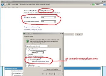

the 'mystery' (Unidentified network - Public network) network you're experiencing--is your wife's 'wireless' connected machine.
Check to see if her wireless adapter is set to 'sleep/hibernate' (it shouldn't be, as this 'could' be the cause of the problem). Also check to see her 'power options'. see attached pic
I believe you actually have 'two' networks--one wired and one wireless.
(make sure the wireless is 'secured' with a password).
note to properly power cycle:
Power off everything (unplug modem).
Wait several minutes.
Power up modem.
Wait for modem to sync with ISP (a minute or so).
Power up router.
Wait for router to sync with modem.
Power up computer(s)
