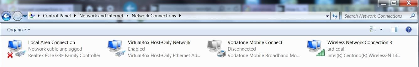

- When you say a modem - do you mean Network Connection? Look at the screenshot
- Or do you mean (1) is modem/router and (2) is wireless access point?

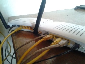

Right modem 1, left modem 2(wifi).
The ports that have color yellow frames are the LAN ports. And the silver router is on LAN port modem 1 connected on WAN port on modem 2.

Do you have 3 different computers? All yellow cables go to a different computer? If any yellow cable go from modem 1 to modem 2 then remove it. Only cable between modem 1 (LAN port) and modem 2 (WAN port) should be the grey one. PC can connect to any yellow LAN port on either modem 1 or modem 2.
Let us know how it goes after you remove that extra yellow cable between modem 1 and 2.
(By the way, it is 3:22AM here, so I am going to bed and won't be able to answer. Hopefully, this will solve your problem. If not, check modem 1 management interface to see if it is in bridged mode, and disable bridged mode if so. It should be doing NAT.)

Looks like one yellow cable goes between modems, connecting the Wireless router to the wired router.
I removed the yellow cable that connects modem 1 to 2 and its working now :).
Thank you so much guys for your suggestions.
But why last week it was just working with a yellow cable like that? Does the DHCP enabled makes the conflict?
Custom build
Yes, you can connect yellow the cable from modem 1 LAN to modem 2 LAN (remove grey cable in that case). But make sure to disable one of the DHCP's. Two DHCP simultaneously will cause problems.
