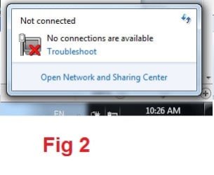

i had this problem on win7 laptop, instead of shutting down the computer i put it to sleep, so that laptop awakes faster,
however sometime when i wake up the wifi adapter dont work, meaning that when i goto network and sharing center the wifi adapter is not shown, so i have to reboot the system for wifi to work.
this is only happening in my Dell A860 Vostro Laptop running win7
i have HP laptop running win8, and i never ecnountered this problem on HP

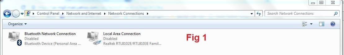

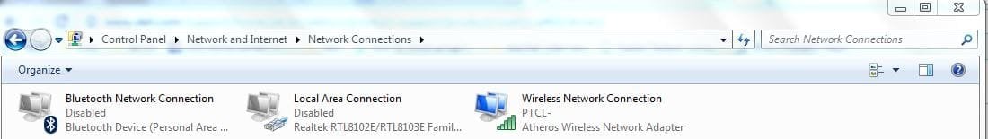

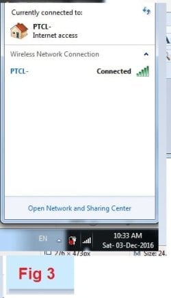

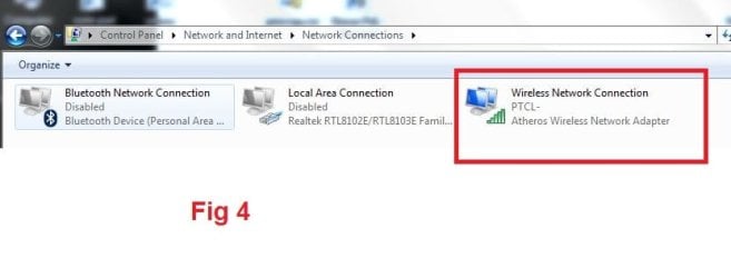

fig 1 and 2 shows that wifi adapter is not available and after reboot fig 3 and 4 shows wifi connected to PTCL- netwrok and wifi adapter visible in network and sharing center

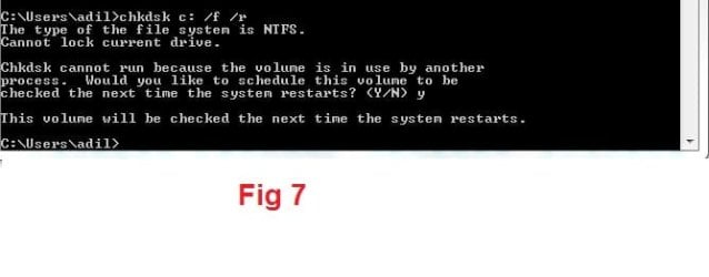

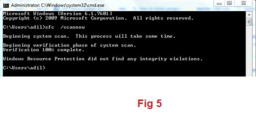

Hello
i have run both the following commands
SFC /SCANNOW
Disk Check
see the screen shots

i have run both these commands
SFC /SCANNOW
Disk Check

Ok mate sorry late reply the scans were just to make sure the system OS was in correct working order and that there were no corrupt files lying around because a few corrupt files could possibly be what is causing your issue/s - it is something I always check first if my machines are playing up.

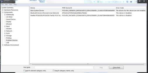

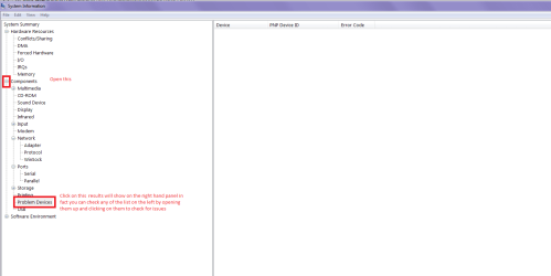

Now one other thing you can do is to go into Start> type "msinfo32" (without the quotation marks) > open it and go through the various sub categories and look for problems within the different components. One I always look for is Problem devices see my pic
1920x1080 D1 & D2 & Laptop 1
Desk1 Samsung 120GB 830 SSD
Asus ROG 256GB 850 Pro SSD
Desk2 Samsung 840 256 SSD
Toshiba 120GB EVO
ADSL2+
Canon MG5250MFC
what is a base system means
i have disabled the ethernet and bluetooth adapter
yes i put the computer to sleep so that it awakes up faster

Ok well I knew here had to be something amiss within the machine but not sure if it was hardware or software.
Now the Base System is to put it simply one of the many devices within the machine that make the system run properly.
Now this is one reference to this issue Base System Device Error in Device Manager and it is advising that you update he chipset for your laptop and it can be found here Support for Vostro A860 | Dell Australia lets try this first.

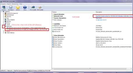

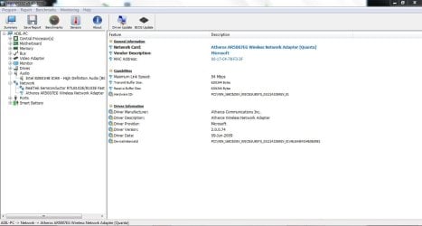

Open each small square with + in it on the section the components are in and then click on the individual component/s (it will highlight in blue) - in the right hand side will appear all sorts of details including brands speeds and other essential info that particular device. See pic for example.
Use Part B: let us know what that model is if you cannot find it

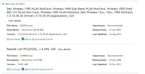

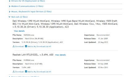

i couldnt find atheros driver on dell website, so i downloaded the first option in networking driver R205204.exe but when i try to isntall it, it should said Operating system is not supported see the screen shot. i am using 32bit windows7

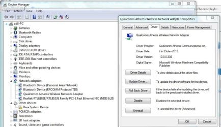

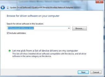

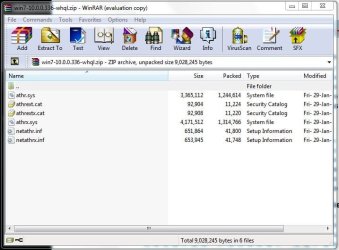

ok i have upgraded the drivers from Select Qualcomm Atheros wireless driver for AR5007EG wifi adpater
and then i was able to install the new drivers from device manager

the wifi porblem has not occured since i upgraded the wifi drivers
thanks all of you
