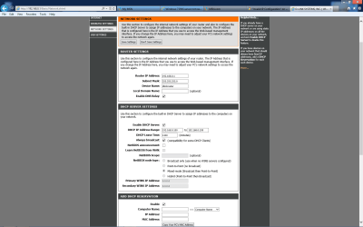

Maybe this picture from my D-link router will help.
Looks to me like the incorrect static IP settings were being used here. The Op was getting his settings from the WAN page then applying them to the LAN settings.
I would think that the standard DHCP settings would work.
