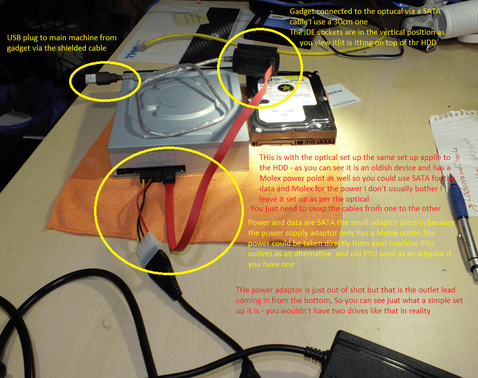

Thought some might be interested to see how I set up "the gadget" can't do without it myself.

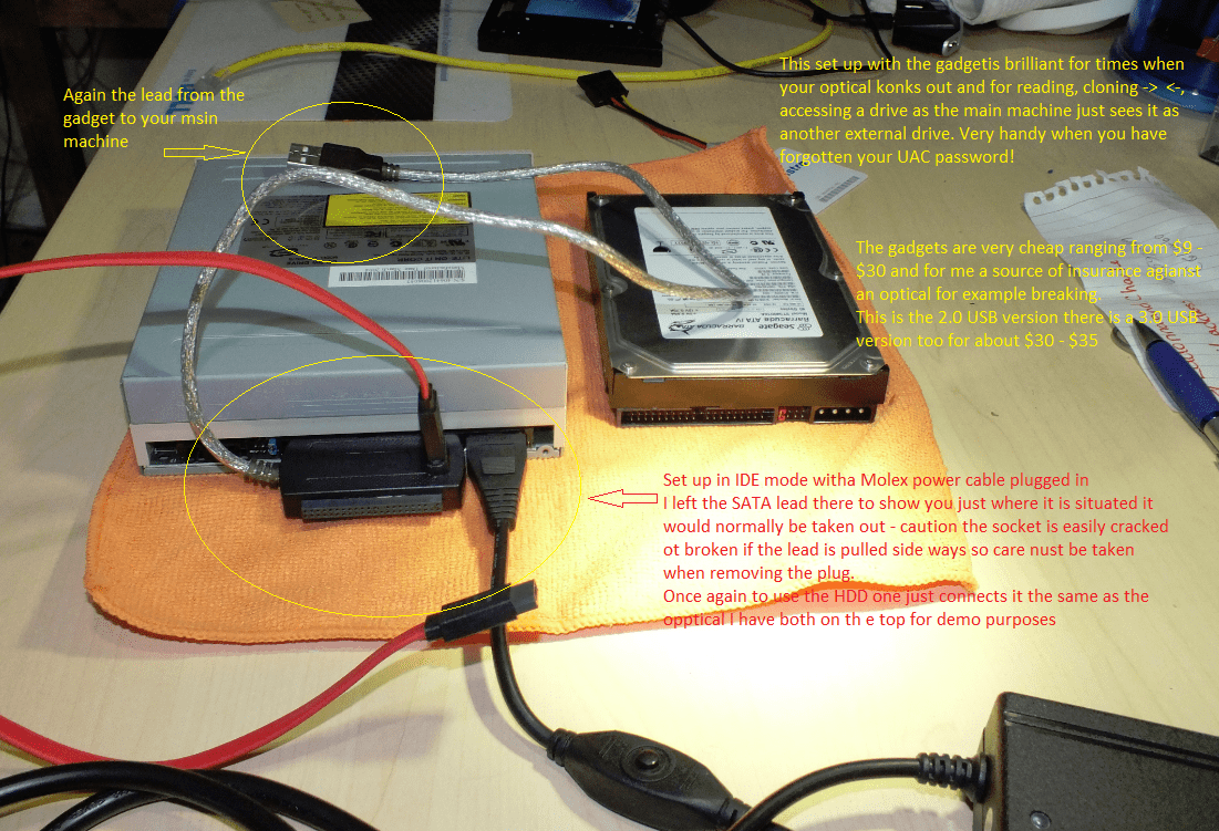

Hum Second set up didn't upload so...

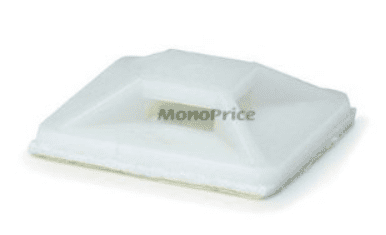

Every time I wire a case, there are always places you need a tie down but there is not one available. So, I've found the solution. These come in white, but a can of black spray paint fixes that and they are not even noticable. They have an adhesive backing and you just stick it on wherever you want and run a cable tie through it. And they stick good if you get the 1" ones. They make them smaller, but those won't stay stuck, the 1" ones, you'll have to pry off to remove it.
