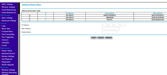

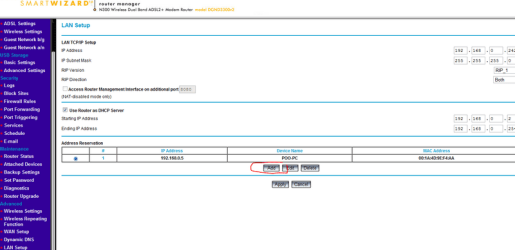

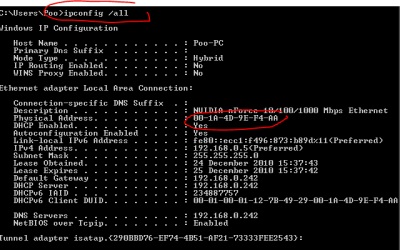

Alternatively you could assign the IP address in the router settings via the MAC address of each device, this way you would be guaranteed that each device would obtain an IP address that you decide before hand.
To find out the MAC address of your PC's open cmd and type ipconfig /all (see pic)
To find out the MAC address of your Xbox goto the advanced settings or look on the back of the unit (there should be a sticker) (see pic)
Once you have these just logo onto your router and under the LAN TCP/IP Setup you should be able to reserve the addresses you want. (see pic)
Your router settings will differ from mine but the concept is the same on most routers ;)
