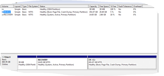

I am enclosing screenshot of Disk Management: Capture.PNG

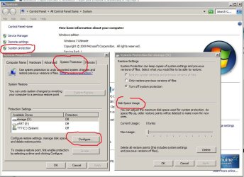

system restore points can take up a lot of space--if you turn 'system protection' off-it will delete all but your most recent restore point--also check 'disk space usage' which can be adjusted (see screen shot)

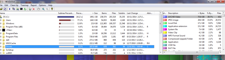

I ran WinDirStat and the total count was 190G with the videos and pictures taking the most space; so my approximate "count" was close. Am I correct in the total count? If so where is the other 300G? Just in case this is important-in my computer, the C drive bar is in red and there is no D drive.

You first post shows your HD as a recovery partition, remember to take it into account when doing the maths.
One more thing, if you look at the C drive properties, how much total and free space does it reports?

Ran WinDirStat as administrator, but still the same results. ??

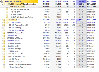

Wow, Treesize is pretty different for the System, but the same for Users! I'm enclosing two snips with the second one expanded on the System to show what it uses (and it is not all shown, just the largest)

If my calculation is right, you have appr. 165GBs that are unaccounted for. Very strange. I really wonder how that could have gone on the disk without showing in the Master File Table.
Have a look into AppData. Sometimes strange stuff is hiding there.
The TreeSize screenshot shows 239 GB on System Volume Information, far more than anything else. This folder is where system restore points are stored, you could try deleting some of the oldest ones or reducing the space assigned to it.

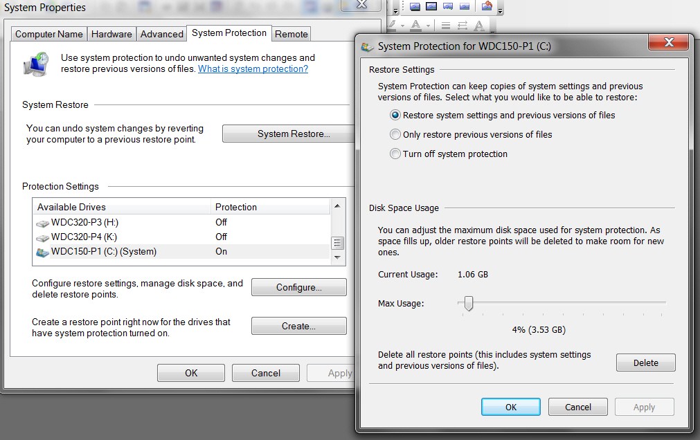

(2) You can easily LIMIT the total amount of space used going into the System Volume Information area (i.e. restore points). You don't need to let this ever happen again, where you're using 250GB of space for system restore points.
Right-click on Computer -> Properties -> System protection, to get the System Properties dialog with the "system protection" tab selected. In the Protection Settings window that shows each of your drives and whether restore points are ON or OFF for each drive, select your "C (System)" drive. Then push the CONFIGURE button to set the limit of how much maximum space on the drive is to be used for the system restore are (i.e. System Volume Information).
Push the OK button (on both dialogs) and from now on Windows will automatically "prune" the oldest restore point(s) when a new one is created, in order to remain within the approximate maximum space limit you just specified for this drive.
There's certainly you have no need for allocating more than 5% of your 500GB drive to this purpose (i.e. under 25GB), and probably less than that. Your screenshot shows each restore point at about 6GB, so that would give you about four restore points in your generational retention. Typically you only ever might make use of the last one (or possibly two) restore points to recover from some problem that doing this could be your solution.
