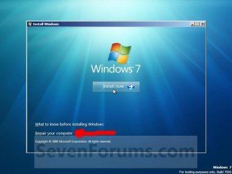

Click on repair my computer.
Mine only says Check Compatability online or install now. At the bottom it says what you need to know before installing windows.

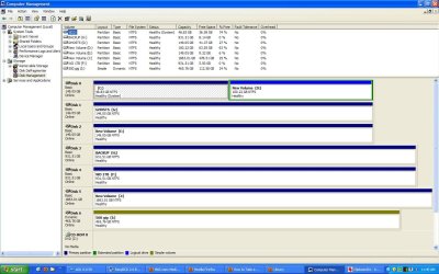

Before doing that can you post back a screenshot of your full Disk management drive map, as we need to see what the exact config is to advise you.

I lost my dual boot because the ghost I used to restore my C drive was made prior to having dual boot so it wiped it out. Im not sure if this is screenshot you want, but you can let me know.

Which OS starts up now? Do you have a dual boot?
You can't recover the MBR into Win7 until it is converted to Primary using free Partition Wizard bootable CD.
But it might not be necessary if the repair reconstructed your Dual Boot with the System MBR remaining on XP. Try it.
The Easy listings look correct, while the Disk Mgmt screenshot is lacking Active flag on XP.
