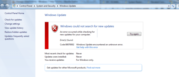

Is there an actual fix to the 80070002 update error?
BrianR1
11:10 PM
38
I've tried the Microsoft fixes, browsed here and at Microsoft, had 2 Microsoft techs take over my computer, and still no good. I had another drive and clean installed Win 7 SP 1, same problem. I checked for viruses, Avast and Malwarebytes, nothing found.
My PC is a homebrew, Gigabyte GA-B85-HD3, Intel Pentium G3258, not OC'd, 16 Mb PNY PC3-28000 RAM. My software is legit.
Originally my problems started with shutting down my PC before going to work and seeing updates are installing, do not shut off machine. I'd get home and see the same message. I'd restart using the resset button and maybe that's what originally through things off if it was hanging. It was still connected to the internet, always is unless I shut down the machine.
As I said I've tried Microsoft fixes but my problem is obviously in the registry, why it would be in my new install in my other drive I have no idea. I'm at a loss and not a software geek, though I can roam around in the system when I have an idea what to look for.
Any ideas?

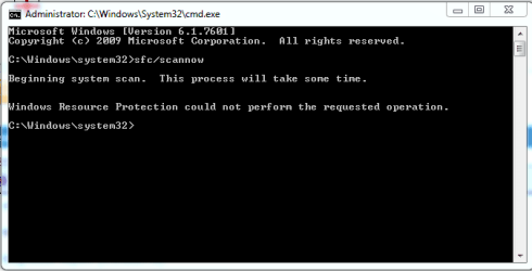

what was the error message from the sfc failure

I must be doing something wrong but I've included the CBS zip and a snip of my update error

Here is the sfc/scannow snip

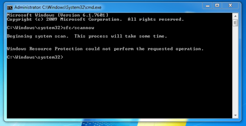

sf/scannow still not working and still getting the 80070002 update error when I run updates.

Just so you know, those 3 files you asked me to run failed with a catastrophic failure. I know that's not on here anymore, was in the email and assuming you edited it out from the post.
