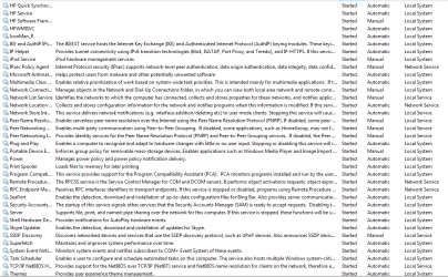

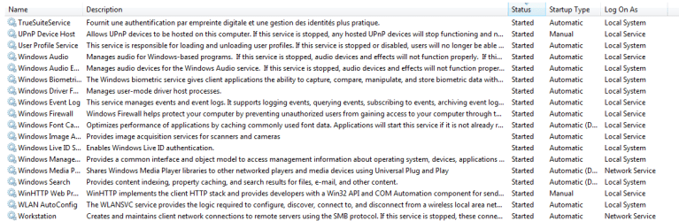

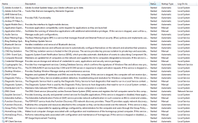

So sorry, here they are. Thanks! Just wanna know if any of these services are gonna significantly slow my computer down.

Hello regulater,
Thanks for replying!
After carefully glancing through your list of services, I've determined which ones you can disable without any consequences...
To change the properties of a service, right click on the entry, click on properties, change the startup type to the status you you want it to be.
The list:-
AMD External Events - it's just a hotkey poller for AMD Graphics Cards and does nothing important
Adobe Acrobat Updater and Adobe Active File - Adobe Parasites, nothing important
Bing Desktop Service - disable this unless you use Bing on your desktop to search
Distributed Link Tracking Client - No important functionality here
HP Auto - HP's pointless tracking service
HP Client Services - Disable unless you use any of your laptop's supplied HP applications
HP Quick Sychro - See above
HPWMISVC - See above
HP Software Framework - See above
Windows Search - Part of the indexing service, can cause massive slowdown if you have not specifically told indexing application to index only specific folders
