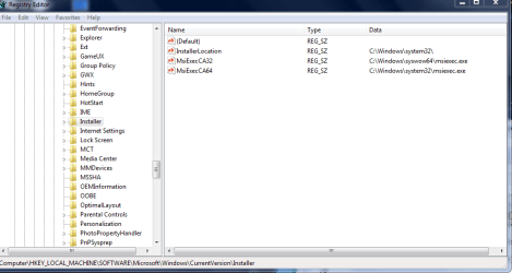

Hi Gr3y,
Normal updates appear to be fine, so that leaves the net installer,
can you navigate to this location
(DO NOT alter them yet, would like to see them first)
Click Windows button and type ‘regedit’ in search bar.
Click ‘regedit’ in search results
navigate to following registry entry HKLM\Software\Microsoft\Windows\CurrentVersion\Installer
Check if following registry keys have correct values:
  • MsiExecCA32 should end with \Windows\syswow64\msiexec.exe
  • MsiExecCA64 should end with \Windows\system32\msiexec.exe
if should look like the screenshot
Can you also copy me your features box
control panel >> programs/features >> features (top left) > a smaller window will open
if Netframework is there expand it
Roy

Torchwood,
Here may well be the problem (I don't have the solution).
Registry entries match yours, but NETFramework is missing, it should appear here sequentially?
gr3yrider

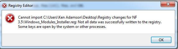

Torchwood,
Glad to hear from you again. I hate when stuff goes down and you lose work! Welcome back.
I did as you suggested and 2 of the 3 services appeared to work, the Windows Module Installer failed with an error, shown in the first attachment. I then closed everything to see if I could get it to merge and I could not. I then rebooted my machine to see if that would work, realizing you had said NOT TO REBOOT YET but I couldn't get the last service to merge. Unfortunately that did not work, I still get the error that is attached to this note.
Should I turn off IIS and reset internet options and reboot again to get the first 2 services to take? I'm at a bit of a loss to know what to do.
As for a repair disk, I've turned my office upside down and found a set of recovery disks that are for this machine, is that what you want? Of course I found recovery disks for earlier machines, XP and a MultiMedia version that I no long have but could not locate something that I had labeled repair disk. I'm sorry. How would you get that stuff to me?
As for your comment about other Intuit users seeming to be experiencing problems with .NET Framework 4.5.2 and W10, I'm not surprised. I personally am not pleased with the lack of knowledge from their support group that has put me in the predicament I'm in right now, just a comment.
gr3yrider
