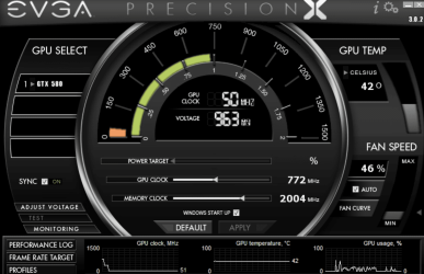

For future reference if you ever purchase evga again use their precision tool from their website. It will monitor the card and alter the fan in real time to avoid heat.
The built in monitor nvidia provides is by and large useless.
I do have to say I'm shocked to hear this as EVGA has general praise from myself and the internet at large even.
Here's a screen from it... as you can see it even clocks the core down to next to nothing if you aren't using it. Gives it about half juice for hd video and only cranks it up when I actually launch a game, at which point it rarely lets the temp over 60 , it's warm right now because I just popped out of tera to post this.

Interestingly, the other son who has an identical system, his card runs in the high 60s to low 70s when running the same game.
I bought a corsair TX-750M modular power supply. This one has all the same safety features, and a 7 year warranty.
In all my years of building/repairing systems I've never actually seen a PSU explode. What fun :D
As far as the graphics card goes; it is only a 3 year warranty. They were pretty good about replacing the other one which was definately faulty. We will install precision and keep our eye on things.
thanks for the tips and suggestions.
I didn't know that the FPS was tied to the monitor's refresh rate. Will check that out.
