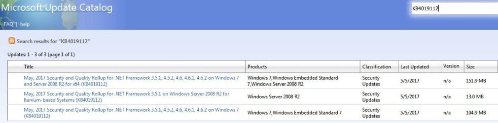

KB4019112 Problem
Well, I think the issue may be that the update covers many different versions of NET. When I went to Windows update catalog and entered KB4019112 there were 3 different versions. Interestingly, none were the 77 Mb that Windows Update reported. Clicking on the largest led me to a page with an error, The second largest opened a page with three 3 .exe files with different KB numbers. I had to enter each one in Windows support to determine which I needed. I selected the one appropriate for my system and did a manual install in which all went fine. Windows Update still reported KB4019112 as an important update so I had to hide it.
This was a royal pain in which the descriptions for the different files were vague or non-existent. Here are screenshots of the files I dealt with.
