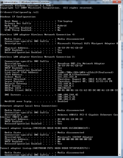

If you can post a screen shot of the ipconfig/all from this machine it would be helpful. :)

Here you go.

Well that all looks fine.
How far are you from the router? Signal strength? Could be interference from outside sources (another router in the area on the same channel etc).
I assume you have a good password and are using WPA2 to connect to your router? (Otherwise maybe someone else is using your bandwidth)
Could even be your ISP, try connecting wired and see if the problem goes away.
Finally, it could be malware or the like messing with our connection :/

Ok, thanks for posting the ipconfig, can you please go into Device Manager, expand network and disable the Microsoft virtual WiFi miniport adaptor. After that, test out the connection and let me know if there are any changes. :)
