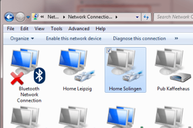

Yes, and it's quite easy to do. Routers and modems we normal users use to connect to Internet normally use IP addresses in series 10.0.X.X, 172.16.X.X or 192.168.X.X. So, for instance your router's IP i.e. your DHCP server address is most probably 192.168.1.1. If you now let's say visited me, you could not join my network keeping your old IP because my DHCP server address is 192.168.2.1
If you didn't have a static IP to connect to my router, it (DHCP server) would then assign you an IP address from my address pool, which I have limited to 99 addresses as this image shows:
If you visited me often, we could for instance agree that you can always use 192.168.2.15 when here. You can set a static IP for every network you normally use as for instance I have set this laptop to have these two addresses (WiFi & LAN) when home here in Leipzig:
When in our other home, other side of Germany, I have two other static IP's. I also have a static IP to use in my favourite pub; the owner is a friend and let's me use his fast gigabit office network so I don't have to use the slow public WLAN when sitting there with my laptop.
To create a connection for every network you regularly visit, open the Network and Sharing Center, click Connect to a network, and follow the instructions.
Go then to each connection's properties and set DHCP, DNS and IP info manually. Result is this:

TLDL all posts. (Also dont want to use any other software)
I sorta see what you guys are saying, but the main reason I want this is even though we both had 192.168.1.1 as the subnet mask, 192.168.1.200 didnt work on my friends internet (it said DCHP or something wasnt enabled) and 192.168.1.150 doesnt work on my internet (Because its already in use by my xbox.)
It connects to the router, but I dont get internet.
And another thing, I cant find that page that chev65 posted. Is it possible because I use wireless or something?
The page is there but I didn't post the exact pathway, wireless or wired it works for both.
In the first window right click the IPv4 line and choose properties, then click the setting to "use the following IP address" this will allow you to choose a static IP in the advanced TCP/IP properties. You can do the same for the DNS server although it usually works best to let the router do that part for you.
After that choose the "Advanced" setting which gets you to the TCP/ip settings window. You then choose the "Add" button to add info from the network you need to set up.
Click add again to set up the next network, you can list the networks one after the other.
It works really well and will retain your static IP's and other settings from each network. :)

Yea but it doesnt let me do that for individule networks. It only lets me do it for my wireless adapter for all networks at once.
I can assure you that it works absolutely perfectly.
If you clicked on the wireless adaptor first then thats the one you will be adding static IP's for. If you need to add extra static IP's for your wired eithernet adaptor then click on the IPv4 properties of your wired connection adaptor. You can add more than one static IP for each adaptor as required.
You need to use the "Add" button after entering the info for each network. The Add button allows you to enter next static IP.
To make this perfectly clear I have set up two different default gateways and IP's as an example. You would only need to enter the second default gateway if the default gateway on the other router is differerent than the first one. :D
I can't think of any other way to explain this better. Hope this helps you out cclloyd.
