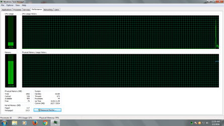

Thank you pal:) Here it is---

To be of any use the screenshot would have to be taken when the problem occurs. The screenshot above shows nothing unusual.

Actually when the problem occurred the following were the figures-
Cached- 400+
available - 400+
Free - 0
paged 200+
non paged 1200+:confused::confused::confused:
so did you got the idea abt what i'm talking abt.. the non paged memory fills up leaving no physical memory..

The numbers provided indicate there is a problem but not what is causing it. I wanted to see a screenshot when the problem occurred. There may be something there that points to the cause. Can't know until I see it.

Here---

There is nothing unusual in the screenshot except the Non Paged Pool which is about 10 times what it should be. Typically this would be caused by a driver problem or malware. Unfortunately this kind of thing can be difficult to diagnose and beyond my experience.
My opinion of programs like Wise Memory optimizer is very low. I have tried this program just to see how it worked and was thoroughly unimpressed. Obviously the authors have no idea how memory is managed in a modern OS.

The culprit was AVAST.. After uninstalling it the non paged memory was just fine.. I have now installed AVG... Yay
