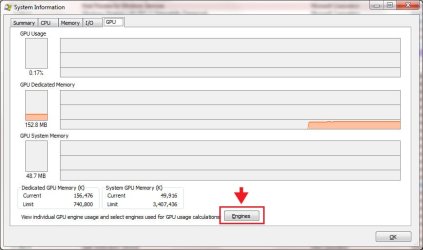

Could you boot into the BIOS, and then post the values for the 3.3V, 5V and 12V rails?
What's task manager performance tab showing while this is going on? | Put that up on one of the other monitors.

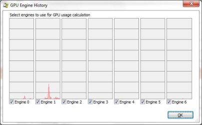

Task Manager with three monitors, Aero Transparency and Firefox open:
