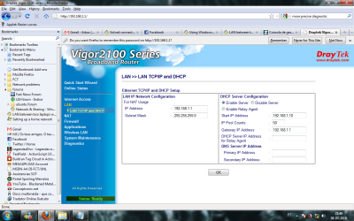

I've sent you an image with the ip address of my router.
windows xp(static):
ip address: 192.168.100.2
subnetmask: 255.255.255.0
default gateway:(let with empty values)
windows 7(static):
ip address: 192.168.100.1
I did the ping with both computers to both ip-addresses with 0% packet loss.

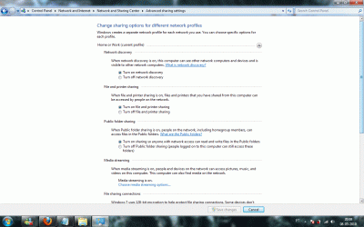

Yes , i need help to create a workgroup. Can you help me with that?
At this time, i can ping both computer ip addresses but i can't see none of them in "my network places".

http://www.acurasd.com/network/Advance%20Sharing%20Settings.JPG
at the bottom of the page... make sure you want to use Workgroup is checked like in the picture on both computers.
make sure that both computers have the same workgroup name too
so they can see one another.

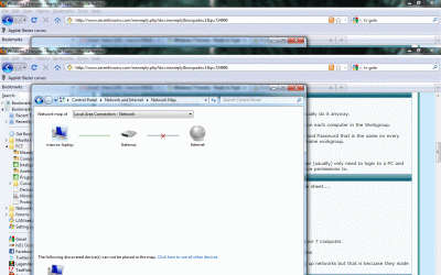

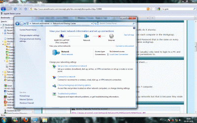

I don't know how to do the steps 1) and 2) . Can you help me with that?
In the step 3), when you say "shot of your network" you mean the network map?
I've sent two images. One with the sharing center and the other with the network map.
In the network map, it is suppose to appear the windows xp machine right?
Once again, thank you very much for your help!
