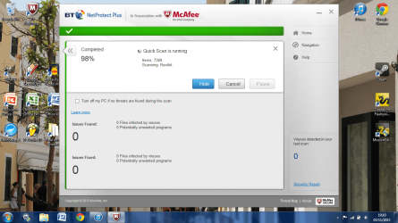

So today I was running a quick scan with my anti-virus/malware software (Bt Netprotect + in association with McAfee) and happened to glance at the screen to see this:
The file being scanned was labelled Rootkit
The quick scan was 99% complete
0 issues had been detected
0 issues has been fixed
My computer was secure, no action required. (according to the software)
The scan was taking quite a while over this mystery rootkit file, leading me to become obviously concerned.
FYI, no viral symptoms have been noticed in the hour or two after I first noticed this file in the scan. I've checked running processes, installed programs, run Ccleaner and multiple custom and complete virus scans using McAfee. I also searched the registry using regedit for any instances of 'bootrecord', although I didn't really know what the 3 returned items meant because I don't know what I'm doing in the registry - which is why i quit regedit and left it alone after that!
Nothing so far suggests I have an infection except the name, the file scan length and one other thing...

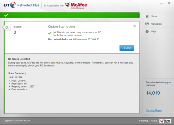

McAfee returns a result in its system scans which has led to much confusion in the past. I intend to also post this on to the McAfee community to try and determine exactly what they mean by it, but so far I'll just tell you what I know.
At the end of a scan of critical system files McAfee with return a result for 'Boot Records'. As I understand it this is likely linked to boot sectors, perhaps logging the number of times a set of files for booting a drive are stored.
Until today it used to return 3 boot records.
Today, the same day that 'rootkit' appeared, it returned 4.
Now I will advise you that the McAfee software underwent a graphical (and presumably virus definition) update in the last day or two also.

Why have my boot records gone up?
I've asked about boot records before and it seems to confuse non-McAfee people, but if you know anything about this please do help clarify. If it means I have files in the boot sector for 4 drives...why? Can I bring it back down to 3?

A print screen taken during scan
Rootkit-scan-411373577
McAfee usually shows files with their directory (shortened if very long)
- eg.
which i have just copied directly from a scan i am currently running
This one was simply 'Rootkit' (as shown in image).
[is this because it's a registry file?]

In case the image didn't work before;
Also uploaded an image showing the 4 boot records field at the end of my system scan

Are you sure Rootkit is a file or is McAfee telling you it is scanning for rootkits?

To be honest, I don't think that folder is actually a Rootkit, I've never seen a malware developer call their Rootkit a Rookit. Have you checked the contents of the folder?

Ok guys I've had this through from one of the guys at McAfee to help clarify the situation:
Moved this from Community Interface Help (ie problems with the site) to Home & Home Office / Virus and Spyware Protection / VirusScan.
Two things here : "Scanning Rootkit" and boot Records.
The wording of that Rootkit message is misleading. We've already had a go at McAfee about this. It means "Scanning for rootkits", not that it's found one. Don't panic. Eventually they'll get around to changing the wording. In the meantime a lot of people get alarmed needlessly.
As for boot records : it's checking the MBR. If it finds an extra record there you should investigate the reason. Run this program and it will tell you what it finds on the MBR - I've downloaded it and tested it. On mine it found only one record.
[url=http://www.majorgeeks.com/files/details/mbrcheck.html]Download MBRCheck - MajorGeeks[/url]
Edit - alternatively there are many other MBR-checkers in the thread at [url=http://malwaretips.com/Thread-MBR-check-tools]MBR check tools[/url]. Use at your own risk, needless to say : I always download this sort of file to a safe place in Chrome, without running it, then upload the file to VirusTotal for checking.
Jim :cool:
I was always sceptical that a rootkit would be labelled 'rootkit'.
McAfee have confirmed that the screen shown is a function of the scan that searches for rootkits, NOT that it is scanning a rootkit.
Many have complained to them about this.
