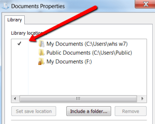

When you go into Properties of the Libraries, there is always one that is marked with a checkmark as "default". That is the one into which files are stored in case you chose the library (rather than the folder) to move or copy data.
My guess is that this one is also deleted when you delete the library. Check whether you still have the "public" Picures, Music, etc. folders because those are not part of the defaults.

Yes I have those folders.
