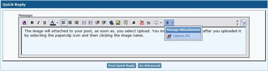

The image will attached to your post, as soon as, you select Upload. You insert the image inline, after you uploaded it by selecting the paperclip icon and then clicking the image name.
Morning Blue Robot. I still can't send you the outorun log. what am I doing wrong.
I am on this page, I go down to manage attachments. Click browse go to my pictures. select Atorun.
the selection comes up in browse box. I click upload. message say' uploading please wait.
then nothing. I come back to this page and there is no attachment. HELP.???

Can you get to the same point as me in the above image?

no I get the box up ,and click browse. Then select the image I want to send you then click upload, it then say's wait file uploading. then goes' off. where you are showing a box with remove on and a attachment I don't' get that.
Can you just upload a Autoruns log file instead? Start Autoruns, and then it should be a simple File > Save. Place the log file (.ARN) into a zipped folder, and then upload to the forum.
