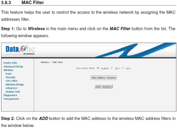

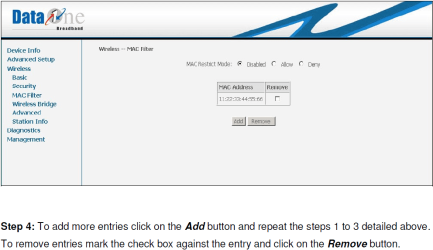

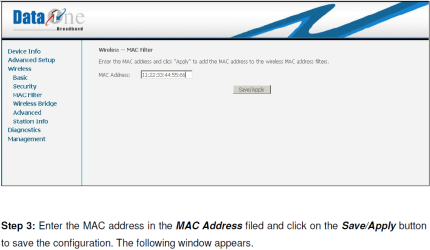

here u go.

Bagavan,
I found this that may help show you how to enter the MAC address like the one here.
See this link as well: http://invincible-gamer.blogspot.com/2009/07/how-to-configure-utstarcom-wireless.html
(You'll need to highlight the text on the webpage there to see it better)

You would enter them as 00:00:00:00:00:00 with the colon. Please see the link above. It gives you step by step for MAC filtering towards the bottom. ;)
