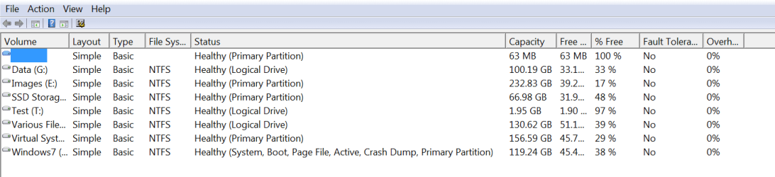

Post a screen shot of Windows Disk Management.
You presumably have multiple partitions--maybe as many as 3. We need to know what's in them and that would be shown by the screen shot.
Choice 1 would appear to include a partition that is NOT needed to restore Windows. Choice 2 would likely be C only or possibly C plus another partition that happens to be marked as "system"---which the screen shot will reveal.
To restore Windows, you need to restore C and any separate partition marked as "system". On some PCs, C is "system", so that's all you'd have to restore. On others, it isn't--so you'd have to restore 2 partitions in that case. Macrium is smart enough to tell which partitions are needed--that's what is meant by "Create an image of the partitions required to backup and restore windows."

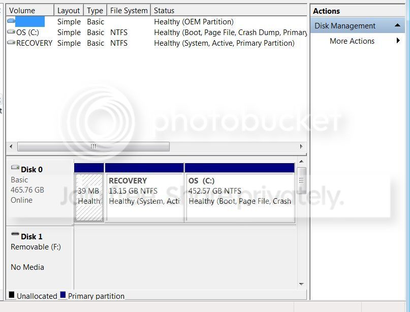

Thanks ignatzatsonic for the info. Here is the pic. Hopefully it's the one you wanted so see. EDIT: The blue square you see under volume is shown as blank.

The difference is the Recovery partition isn't being included in the image of the partitions required to backup and restore windows. The Recovery partition is used to restore your computer back to the factory state should things get hopelessly fouled up. While most purists would say to image that partition separately from the System partitions and even move it to another drive, for you it would be much simpler to just image the entire C: drive, same as you did in Option 1. That way, you will have to make only the one image and it isn't all that much bigger than just imaging the other two.

The recovery partition is marked "system". That's where your boot files are. That partition is needed to restore Windows for that reason, along with C.
This is a Dell. Dell has some weird ideas about where to put boot files. They choose to put them on the recovery partition, unlike most builders.
You could copy those boot files to C if you wanted, and then would only have to image C to restore Windows and programs.
Or leave things as they are and make a single image file of C and recovery.
Or leave things as they are and make separate image files of C and recovery.
Or leave things as they are and make a single image of C, recovery, and that partition with no letter.
Or leave things as they are and make separate images of C, recovery, and that partition with no letter.
I'm not sure what that unlettered partition is. Hmmm...no file system on it. Ask Dell.
Simplest thing to do is just make one image file of all of them, like Lady Fitzgerald recommended. Then you don't have to worry about it.

Since there is a 13.15 GB on Recovery I got confused because Macrium showed a difference of 3.7 GB between #1 and #2 which doesn't correspond with the 13.15 GB Recovery although Macrium compresses the info. So it's Dell that puts the stuff in there.

2. This is a typical Dell setup with the recovery partition as the active partition. For boot purposed that recovery partition needs to be included into the image.
3. If you want to ignore the recovery partition, you can copy the bootmgr to the C partition. Here is how.
It is not the size of the recovery partition that determines the size of the image but the amount of data in that partition. Unfortunately you have posted an incomplete picture of your disk management which does not show how much space is actually being used.
This is how a snip of the complete disk management would look like.

Here is a pic that will show you more of disk management.
To move the recovery disk to C: is above my paygrade as I am an old self-taught noob with absorbing new info and memory problems. Yes, whs, I read the entire link that you supplied in one of your previous posts.
The only thing that concerns me if the Recovery partition will eventually be full, what will then happen as the GBs seem to be increasing and not much space left of 1.94GB

My tutorial does not suggest to move the recovery partition to C. It is only to copy the bootmgr from the recovery partition to C. That is only a few bytes. Then you need not image the recovery partition all the time.
The recovery partition should remain static. It was put there by the manufacturer and Windows or you should not be modifying or adding to it.
Your total occupied space for all 3 partitions is circa 64 GB.
A Macrium image of those 3 partitions should be somewhere around 30 GB in size. You should be able to get a bunch of them on your backup drive.
