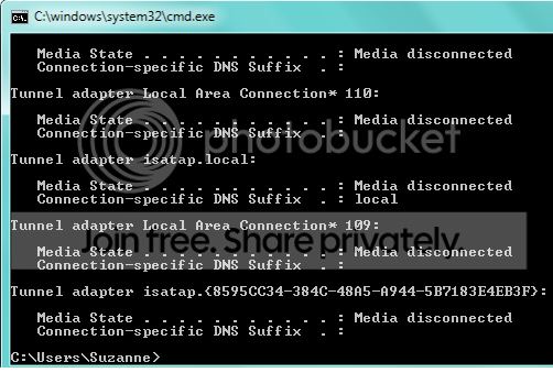

The following is the driver information and ipconfig.all:

Windows IP Configuration
Host Name . . . . . . . . . . . . : Suzanne-PC
Primary Dns Suffix . . . . . . . :
Node Type . . . . . . . . . . . . : Hybrid
IP Routing Enabled. . . . . . . . : No
WINS Proxy Enabled. . . . . . . . : No
DNS Suffix Search List. . . . . . : local
Wireless LAN adapter Wireless Network Connection:
Connection-specific DNS Suffix . : local
Description . . . . . . . . . . . : Atheros AR9285 Wireless Network Adapter
Physical Address. . . . . . . . . : F0-7B-CB-5B-74-49
DHCP Enabled. . . . . . . . . . . : Yes
Autoconfiguration Enabled . . . . : Yes
Link-local IPv6 Address . . . . . : fe80::11e6:c8d8:17ea:2027%20(Preferred)
IPv4 Address. . . . . . . . . . . : 192.168.1.63(Preferred)
Subnet Mask . . . . . . . . . . . : 255.255.255.0
Lease Obtained. . . . . . . . . . : Monday, August 30, 2010 2:25:44 PM
Lease Expires . . . . . . . . . . : Monday, August 30, 2010 5:48:01 PM
Default Gateway . . . . . . . . . : fe80::224:1ff:fecc:ffc%20
192.168.1.1
DHCP Server . . . . . . . . . . . : 192.168.1.1
DNS Servers . . . . . . . . . . . : 192.168.1.2
NetBIOS over Tcpip. . . . . . . . : Enabled
Ethernet adapter Local Area Connection:
Description . . . . . . . . . . . : Marvell Yukon 88E8059 Family PCI-E Gigabit Ethernet Controller
Physical Address. . . . . . . . . : 00-24-54-83-F9-2F
Link-local IPv6 Address . . . . . : fe80::5d3:bbe5:316:ed38%13(Preferred)
Autoconfiguration IPv4 Address. . : 169.254.237.56(Preferred)
Subnet Mask . . . . . . . . . . . : 255.255.0.0
DHCPv6 IAID . . . . . . . . . . . : 285221972
DHCPv6 Client DUID. . . . . . . . : 00-01-00-01-12-FA-9F-49-00-24-54-39-E8-3B
DNS Servers . . . . . . . . . . . : fec0:0:0:ffff::1%2
fec0:0:0:ffff::2%2
fec0:0:0:ffff::3%2
Tunnel adapter Local Area Connection* 16:
Media State . . . . . . . . . . . : Media disconnected
Description . . . . . . . . . . . : Microsoft 6to4 Adapter #5
Physical Address. . . . . . . . . : 00-00-00-00-00-00-00-E0
DHCP Enabled. . . . . . . . . . . : No
Tunnel adapter Local Area Connection* 15:
Description . . . . . . . . . . . : Microsoft 6to4 Adapter #4
Tunnel adapter Reusable Microsoft 6To4 Adapter:
Description . . . . . . . . . . . : Microsoft 6to4 Adapter #2
Tunnel adapter 6TO4 Adapter:
Tunnel adapter Teredo Tunneling Pseudo-Interface:
Description . . . . . . . . . . . : Teredo Tunneling Pseudo-Interface
IPv6 Address. . . . . . . . . . . : 2001:0:4137:9e74:3839:3fad:3f57:fec0(Preferred)
Link-local IPv6 Address . . . . . : fe80::3839:3fad:3f57:fec0%22(Preferred)
Default Gateway . . . . . . . . . : ::
NetBIOS over Tcpip. . . . . . . . : Disabled
Tunnel adapter Local Area Connection* 14:
Description . . . . . . . . . . . : Microsoft 6to4 Adapter #3
Tunnel adapter Local Area Connection* 18:
Description . . . . . . . . . . . : Microsoft 6to4 Adapter #7
Tunnel adapter Local Area Connection* 20:
Description . . . . . . . . . . . : Microsoft 6to4 Adapter #9
Tunnel adapter Local Area Connection* 17:
Description . . . . . . . . . . . : Microsoft 6to4 Adapter #6
Tunnel adapter Local Area Connection* 22:
Description . . . . . . . . . . . : Microsoft 6to4 Adapter #11
Tunnel adapter Local Area Connection* 19:
Description . . . . . . . . . . . : Microsoft 6to4 Adapter #8
Tunnel adapter Local Area Connection* 25:
Description . . . . . . . . . . . : Microsoft 6to4 Adapter #14
Tunnel adapter Local Area Connection* 21:
Description . . . . . . . . . . . : Microsoft 6to4 Adapter #10
Tunnel adapter isatap.local:
Description . . . . . . . . . . . : Microsoft ISATAP Adapter
Tunnel adapter Local Area Connection* 109:
Description . . . . . . . . . . . : Microsoft 6to4 Adapter #98
Tunnel adapter isatap.{8595CC34-384C-48A5-A944-5B7183E4EB3F}:
Description . . . . . . . . . . . : Microsoft ISATAP Adapter #2

something I can say is worth trying is to reset your IP address and see if it will automatically get a new one.
go to a command prompt by typing "CMD" into the searchbar
in the command prompt type in
ipconfig
this will show you what your current IP address is (Write/Copy this info down or take a screenshot)
next type in
ipconfig /renew
See if that gives you a different new ip address.
When I typed in ipconfig, I was met with:
