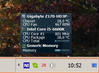

John, I don't think you need more than 8G and will never use the added RAM.
I have (4+4)G and never seen more than 5 in use.
Did you do a RAM test? Is your BIOS up to date?
I have Open Hardware Monitor, a small program that shows the temperatures on the task bar and a small window on the desktop that you can configure to show used memory.
Open Hardware Monitor - Core temp, fan speed and voltages in a free software gadget
