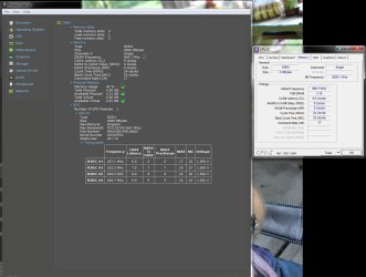

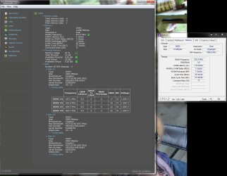

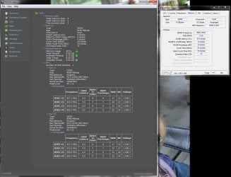

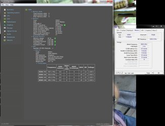

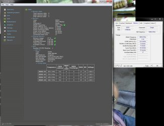

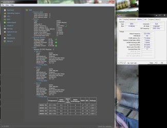

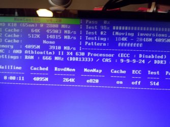

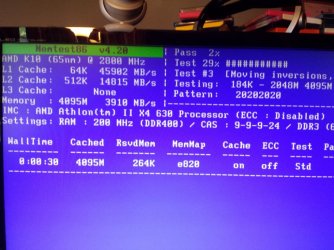

Test results
There is something very odd going on, it seems.
Same stick of RAM for the memtest screenshots and the single-stick reports from Speccy/CPU-Z.
In slots 1-3, memtest86+ reports 666 MHz, 9-9-9-24
In slot 4 (same RAM stick), 200 MHz, 9-9-9-24
If I have RAM in 1 or 2 slots (any 1 or 2 slots) I get 666 MHz, 9-9-9-24 from CPU-Z.
But if I have 3 or more (anywhere) it shows 533 MHz, 7-7-7-20.
Weird, huh?
Not conclusive, but no BSOD in the day and a half or so I was running with RAM only in slots 1 and 2.
Thanks for the help.
