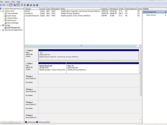

Will do but it might be a day or two before I have a chance as I'll be away from home for a bit. I'll post the screenshot as soon as I get a chance.
Windows XP
Ok screenshot attached. Is there something wrong with this?
Well, yes and no. It obviously works, but....
I haven't seen this before, but the installer put the 100mb system partition on another HD with the data drive. I'm not sure how that could happen.
Normally the System partition would be established in the space to the immediate left of the Win7 partition. This way the HD is independent from any others.
The way it is now, you must have both HD's to start Win7.
The fix for this depends on whether you want the 100mb System Reserved partition, which contains the MBR that would otherwise be within the Win7 partition, but also often gives you the Repair tools which are on your DVD available by tapping F8 at startup (Check and see).
If you want to keep the 100mb partition, then I would move the data off of that drive, use free Partition Wizard CD to delete data drive, shrink the Win7 partition, copy it into deleted data drive space, then delete the old Win7 drive, create new partition(s) as desired, format logical and copy your data there. Make sure this drive is now set to boot first in BIOS setup, after DVD.
If you want to get rid of the 100mb partition, then mark the Win7 drive active, unplug the data drive temporarily, set the Win7 drive to boot first in BIOS setup (after DVD) then boot into Win7 DVD Repair console and run Startup Repair 3 times to write the MBR to Win7 partition.
Now plug the data drive back in to delete and format before copying data back. This may require setting the drive inactive first in order to delete; use Partition Wizard CD or DISKPART commands from Win7 DVD.
When I was installing I deleted some paritions and as I mentioned before there were more than I expected so its possible that I was seeing the 100mb partition and without knowing what it was Windows then went ahead and created it on the second disk. That is the only thing I can think of that might have caused it. Anyway from reading your post would I be correct in thinking that there is no real problem with the partition being on the 2nd drive? It doesn't bother me and if it isn't going to impact on performance or stability then I don't see any reason to change it. Or is this something that might cause problems somewhere down the line?
Windows XP
It could be a problem if that data drive gets marked active, or becomes disconnected, since the Win7 boot partition is somehow on that drive also.
I personally would not want my Win7 installation dependent upon another data drive.
If it was formatted logical (as a data drive really should be) then it couldn't become active, but I don't think that is a risk unless further installs are done.
Copy the steps I gave above so if you have any problems you have the way to fix it.
Essentially removing the data drive requires running Startup Repair 3 times to write the MBR to Win7 drive once it is marked active.
