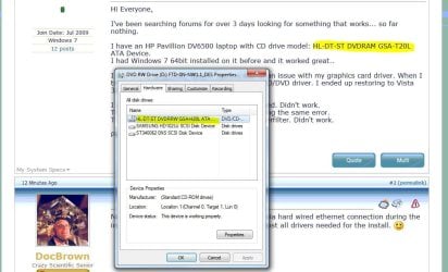

Looks like I have that same DVD drive, it did not need drivers during the win7 install.
