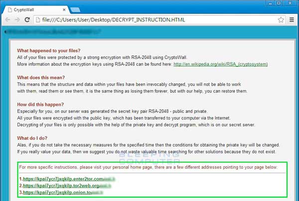

Somehow I have been clobbered by a stubborn piece of Malware - I guess you could call it
DECRYPT, MS SE caught it, that was GOOD, I did a FULL Scan so it could ferret everybit of this
creep OUT for me....after like 3 hrs of scan it reported that it was ready to CLEAN. So I executed
that option naturally. MS SE - now sees Nothing about DECRYPT on my 'puter now.....BUT.......while,
hopefully it may not be functional, when I start my 'puter up the WARNING type "letter" first pops up
and tells me that DECRYPT has "captured/blocked" use of all my files......and to get back to normal
I am to pay a "ransom"......next thing is a Forum/link with code to go to their site and PAY.
The thing is......none of my programs or files appear to be Blocked or Unuseable.....my 'puter thus
appears to be operating as Normal....it is these warnings when I start up [can't find anything in the
list of Startups this time that would tell me.....this is theirs and delete it]........so don't know how they have that hidden.....must have snuck it into something already on my Start Menu???
I past few hrs trying to figure this out.....I have found that they have placed copies of those two items
that appear on startup in probably a lot of my Files. I had some in my Trash....they did not Delete or Recycle when I told it to empty. I manually deleted a couple.
PLEASE advise.............TKS! Michael
