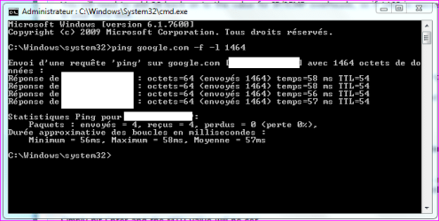

Very interresting...i mean the command...I done the ping and got the value 1464 then add 28 and got the original value i did settle since i've got XP = 1492...(the normal setting!)
Thank you it had confirm my first ping parameter i'd set online, few years ago with an optimizer tool.

Quote: Originally Posted by toussaint89
Is that what you've set, or is that the default of it in Windows?
thats what i get when i do the mtu packet to like google and such i was trying to find my optimal through cmd prompt and i can't get above 900 or it says i have to defragment it more.
What's your current setup for your connection i.e. do you use wireless, or wired connection etc?
I have a wired connection i wont use a wireless. I think it is just my ISP they are complete crap. I pay 70 dollars a month for 1.5Mb and i usually get 400-500Kb which is ridiculous, its the only thing i can get here. But, other then that idk what it could be at all.
Windows 7 professional
mine was 1460 at its best i still kept getting 25% loss it was going back and forth with 0% loss and sometimes 50% loss and when i would switch to 1461 it was worst same with 1459 i ran each like 10 times before deciding which one was the best .
But i couldn't find one tha was 0% loss all the time ,is this normal?
