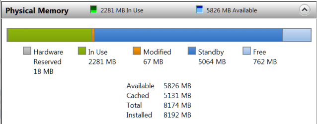

Also, could you post a picture of your Resource Monitor > Memory tab (the colored bar and the nums below). Like this:

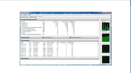

1) If you are using Paint to save your screenshots, grab the lower right corner of the whiteboard area and drag it to the upper left corner. Leave a square that is less than an inch in size. Close Paint while the whiteboard is that size. Then you screenshots should not have all of that white area around them.
2) Are any of the Explorer instances communicating with the internet?
Resource Monitor > Network tab > Network Activity area.

Here is the network page
